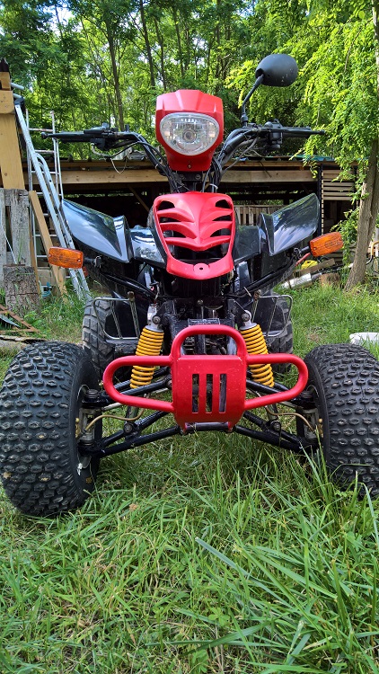

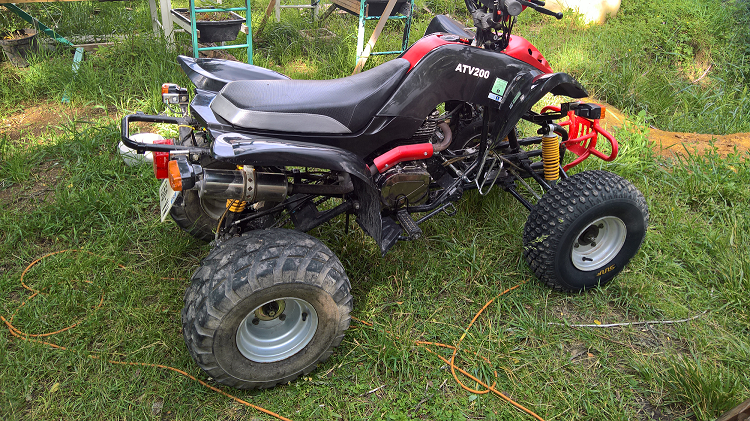

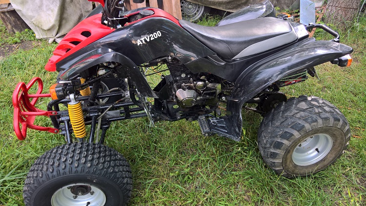

PostPosted: Mon 10 Jun - 18:49 (2019)    Post subject: quad de nono mi route mi chemin Reply with quote
Voila des photo du quad
Temps que sa roule sa roule

PostPosted: Tue 11 Jun - 19:52 (2019)    Post subject: quad de nono mi route mi chemin Reply with quote
super sympa ce petit quad
